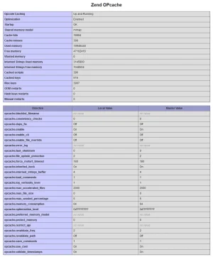

I use php 5.6.x with php redis on:

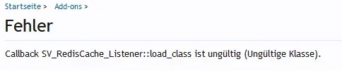

But when I try too install (first I upload the upload folder) the addon - I see that:
Whats the problem? Can anybody help please?
@otto that is XF being unable to find the class. Make sure the files uploaded correctly.
If you have opcache.revalidate_freq set to non-zero an ini file, try restarting php/apache . I don't recommend having opcache.revalidate_freq set to non-zero if you are installing add-ons or making template changes.
@otto can you try uninstalling and reinstalling the add-on? And making sure the files are accessible by the php/web user?
