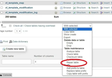

Typically that error will occur when your SQL server instance has crashed unexpectedly. If it continues, you need to resolve the SQL server crashing issue with your host.
Phpmyadmin is a tool/application, not a file.
Mostly you can find it via this url:
http://yourdomainname.com/phpmyadmin
Ofcourse, replace with your own domain name. ;)

I think I did this.
How can I tell if it worked?
Do you still receive this error? Check your Server log.
Admin > Logs > Server error log
