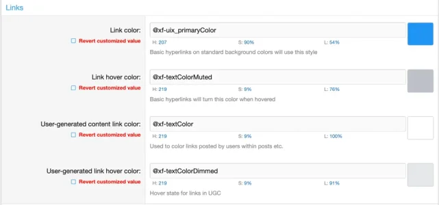

I see. Are you able to successfully make changes to Style Properties > Links > Link color (and hover) on your end under XF 2.3? Every attempt I have made will not work, it's being ignored.
Im having the same issue as you. The link color is very hard to read and is ignored on XF 2.3. The link color won't set no matter what and the hover color is dependant on that. Haven't tested 2.3.2 yet. I ended up adding custom css in extra.less to force the link color to be blue instead of the unreadable dark gray it was.

The Link color is ignored no matter what it was selected to. I still have this custom CSS to override it back to blue
.bbWrapper a.link {
    color: #4080FF !important;
You can interestingly see with certain links that it's this unreadable gray and other times it's blue
I'm about to upgrade to XF 2.3.2 and I'll see if it's fixed.
Edit: still happening on XF 2.3.2 with the latest themes
