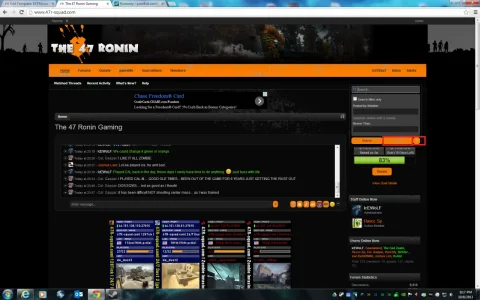

Thanks Russ, I updated the style font color over, it changes for the nav and the forum category sections, however for xenporta titles, it's not changing the colors.
Also would it be possible to clean up the double gray bar in XenPorta in the News area?

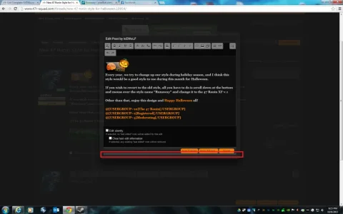

It appears I was able to replicate the gray bar on the edit area too:

Try:
.xenOverlay .section .sectionFooter
padding: 0px 10px;
html .xenOverlay .sectionFooter .buttonContainer {
line-height: 22px;
in extra.css

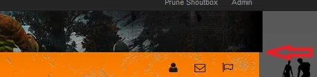

It looks better, the Xenporta is still there, but this is much much better!
Ya it's that control on the left side, so only you/moderators should see it for now, since there's so many fixes in regards to the sectionFooter I may just redo that image and make it taller, that will fix it globally. I'll try to get to it tomorrow.
