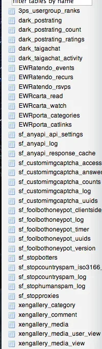

It's actually done as both - but I prefer the non-xf prefix as it makes it a LOT easier to spot them - as you can see by the attached images (the majority of which use their OWN table names).
There is no forced standard here, it would be unenforceable. I believe I've seen it around here that its preferred to be xf_prefix_* to group everything together.
I know... and what I'm relaying is my personal preference. It makes it a lot easier (and less error prone) for ME if they aren't prefixed. I have been know (when tired) in the past to accidentally drop the wrong table because I highlighted the wrong xf_ prefixed one. The non xf_ prefixed ones make that a little less likely.
