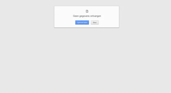

What do yu mean it blocks it? We use the Facebook login function where users can login with Facebook without any issues. Are you getting any specific errors?There is something with this addon that blocks the facebook and twitter integration by login.
Doe anyone else has this problem?

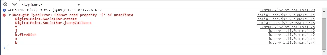

What's your URL? Try running the cron task that goes with it manually? Maybe it just hasn't picked them up yet (it only gets the Tweets every 20 minutes by default).Just had a play at setting this up, and I'm not getting anything loading in the social bar (apart from the buttons). I've got a list defined with some members in them. I'm seeing this in the error console
That's sorted it.What's your URL? Try running the cron task that goes with it manually? Maybe it just hasn't picked them up yet (it only gets the Tweets every 20 minutes by default).
